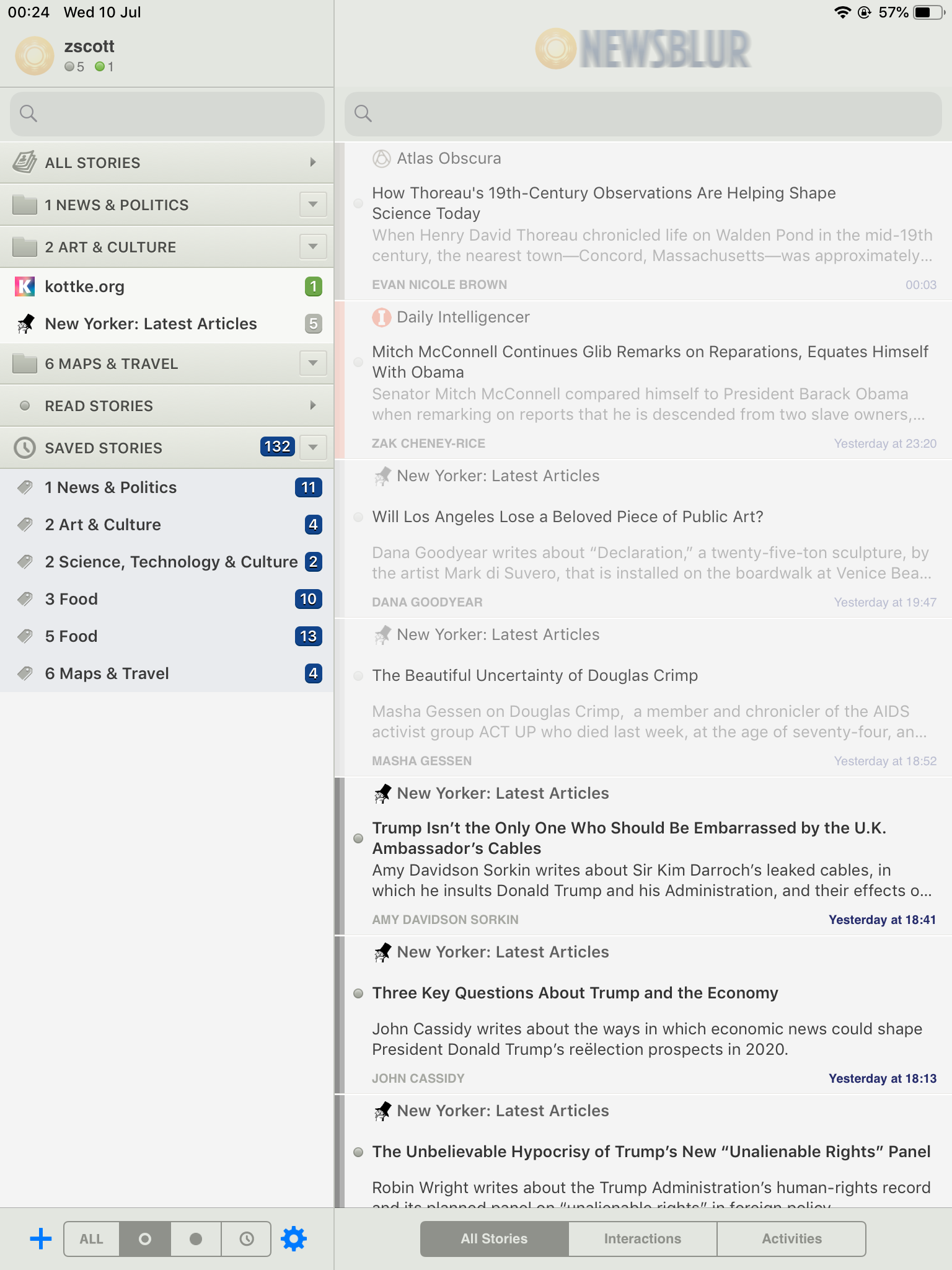

I’ve noticed a few glitchy behaviours in the iOS app UI ever since the latest update (v.9). Often it seems related to when I open a link in browser and then tab back into NewsBlur.
For example, in the first photo the post being displayed is read, but in the left pane it is showing as sort of half-greyed out and the thin leftmost bar shows it as unread. This is after having already displayed as “actually” read /fully greyed. The actual state also seems to be read, because attempting to mark it as read by dragging in the left pane resets it to unread.
In this one you can see at the bottom the cogwheel and plus sign have turned bright blue for some reason. If I tap on the wheel for a second it reverts immediately to the correct colour scheme.
Here you can see two tabs for “Scroll horizontally”.

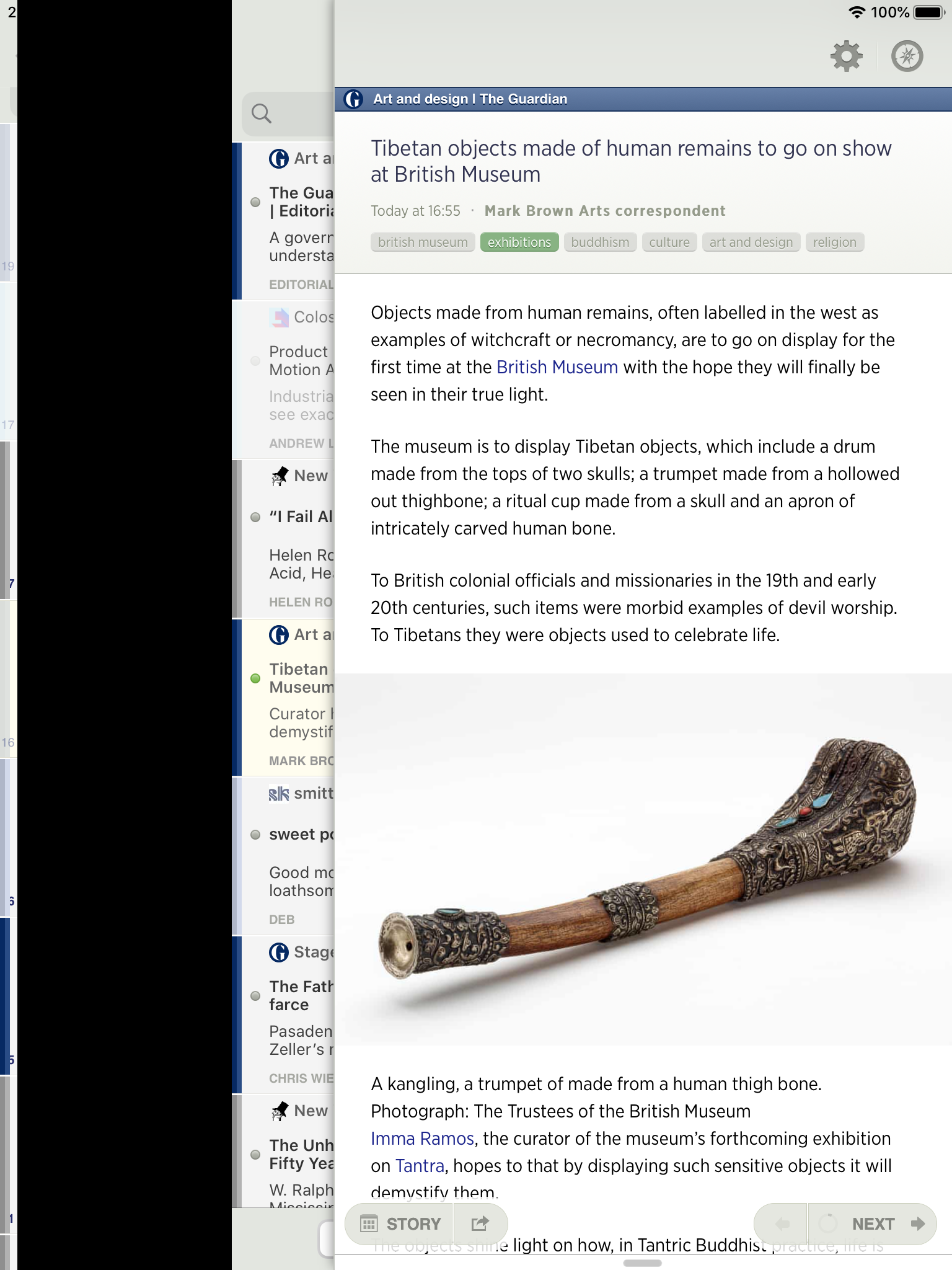

Thanks - it seems like in 9.1 this may now be resolved but this evening on iPad, take a look at what is now happening when I tab out of NewsBlur and back in to it… only resolved by closing the app and reopening:
The left pane is still responsive if I tap in the narrow column where it is visible, but the big white block doesn’t respond in any way.
I’m experiencing the same issue that Zach is experiencing (latest version 13.1.2 of iPadOS on an iPad Air 2). See the screenshot below.
Only closing and restarting the app fixes the issue.
How do you get into this state? Is this when you switch from another app? From returning back into the feed list? Swipe? Button? I’ve also reopened the issue so we’ll get it fixed soon.
It happens for me when switching from another app (when Newsblur is trying to regenerate the list of unread stories per folder, presumably).
Interestingly, if I unlock my iPad’s orientation, and switch from portrait to landscape, it’ll force a refresh, and the left panel will be fine again.
Likewise.

Just to followup on this issue, the latest version of the iPad app appears to resolve things (no problems at all since the update).
Agreed, much improved since v.10, thanks! I did have the below happen a couple of times (now with black bar instead of white!) but I can’t replicate it so far.
