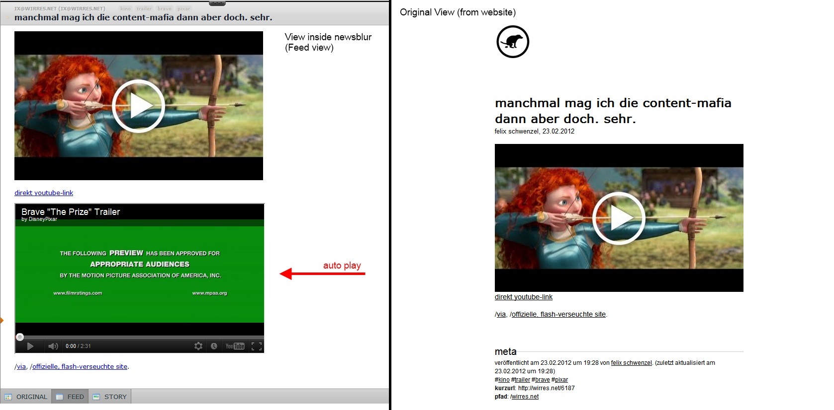

I had the problem for example with that post yesterday: http://wirres.net/article/articleview…
On the website and inside google reader, the post only contains the embedded video and a link to youtube. Inside Newsblur, it seems like the youtube link is loaded additionally as there are two videos displayed, see screenshot attached.
This only occurs in the “feed view”, maybe it is related to the design of the site. If you don’t find a solution, I’ll just use an extension for that, that’s no problem.
Anyway, Thank you very much for your help already.
Yeah, unfortunately, it’s because the blog author is both an image link AND an embedded iframe video. It doesn’t auto play for me because of my plugin: http://cl.ly/EVKu/Screen%20Shot%20201…
