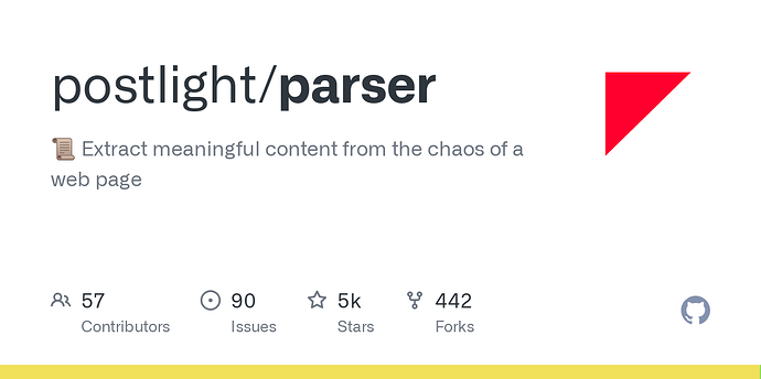

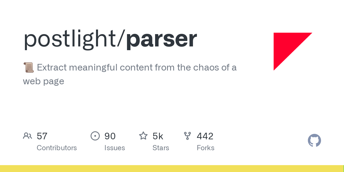

These images are broken only on the Text view and not the Feed view, right? The Text view uses Postlight’s Mercury Parser, and it seems to be having an issue on the relative images. Normally they are taken care of correctly, but in this case something is broken.
It’s upstream of NewsBlur and honestly, if you want to get this fixed, post the URL to the broken story (not from NewsBlur but from the original site) to the Mercury Parser github:
Thanks Samuel - I’ll report the posts to that github repo. I am indeed using the Text view. Is this also the cause of the broken links?
Yep, undoubtedly the same issue.
