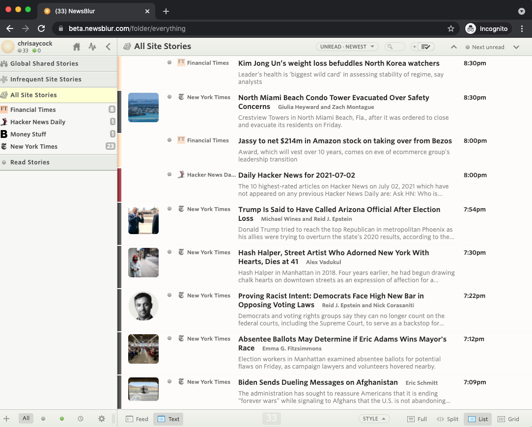

Can you share a full browser screenshot of what you see? Or if you know how to use the developer console, do you see an error message?
From Safari:
From Chrome:

The view panel is still blank. Safari 13 looks like the first picture above. Chrome shows everything just fine.
