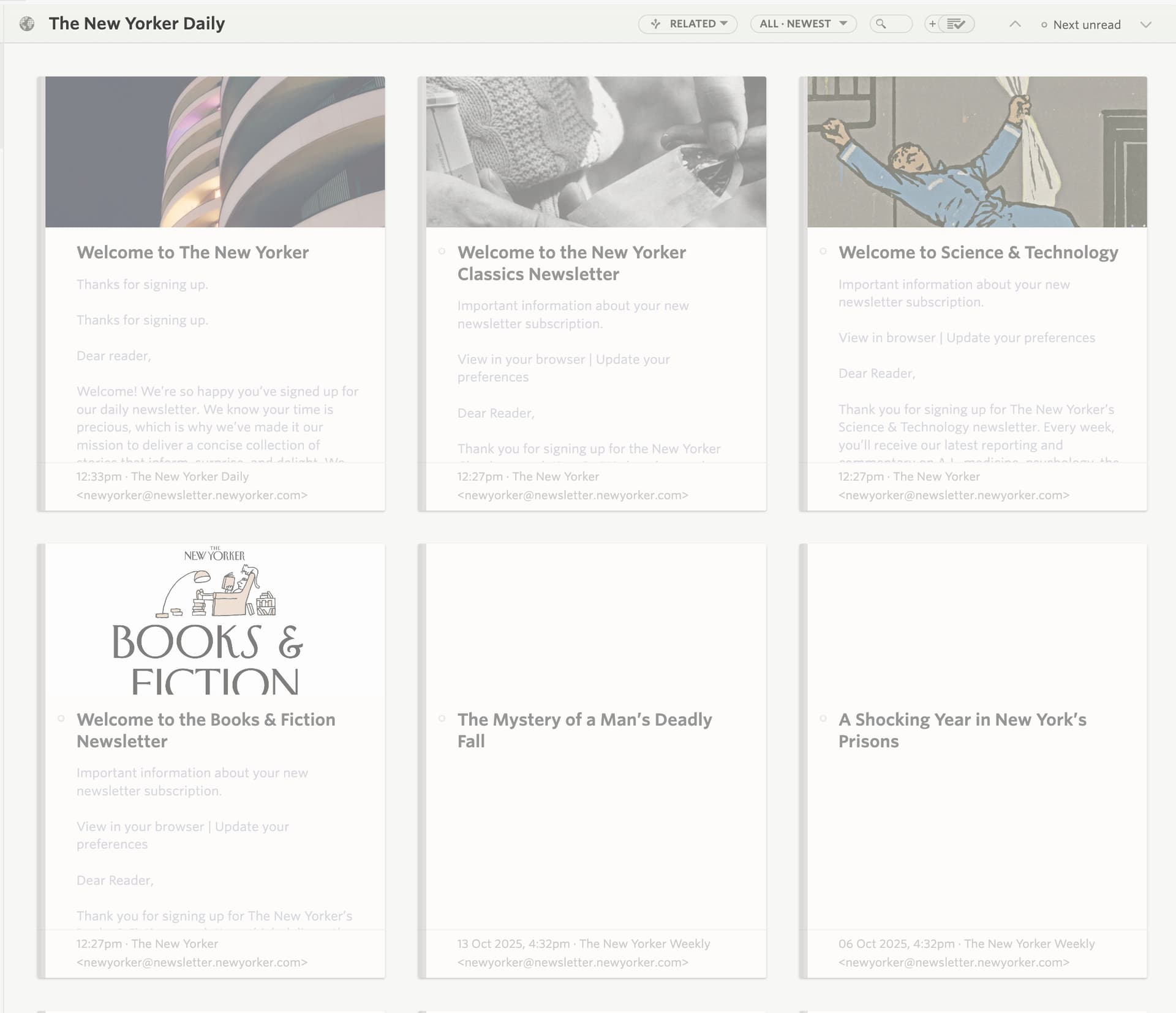

Hi,
First I want to say that I have been using Newsblur for years and it’s been such a fantastic experience. I have been using Newsblur to read my newsletters and only New Yorker (sent from newyorker@newsletter.newyorker.com) shows up blank. The newsletter title shows up correctly but there is no content whatsoever.
There is no hurry to fix this as other newsletters work perfectly fine. Thank you!

Hi Samuel - I wanted to check in and note that I’m having this same problem with Helen Rosner’s newsletter, except that I have a rule in my email client auto-forwarding to my Newsblur import email address. I confirmed that it shows up correctly in my email client, but is blank in Newsblur.

I switched email providers last week, so it may be processing better now. If not, I’ll fix it. The welcome letters came through just fine.
Received a couple blanks ones today and fixed logging so I should have something to investigate tomorrow I hope.
Thanks Samuel! Yes, I’ve seen the same thing (the actual newsletters are blank but other email communications from them seem to work fine).

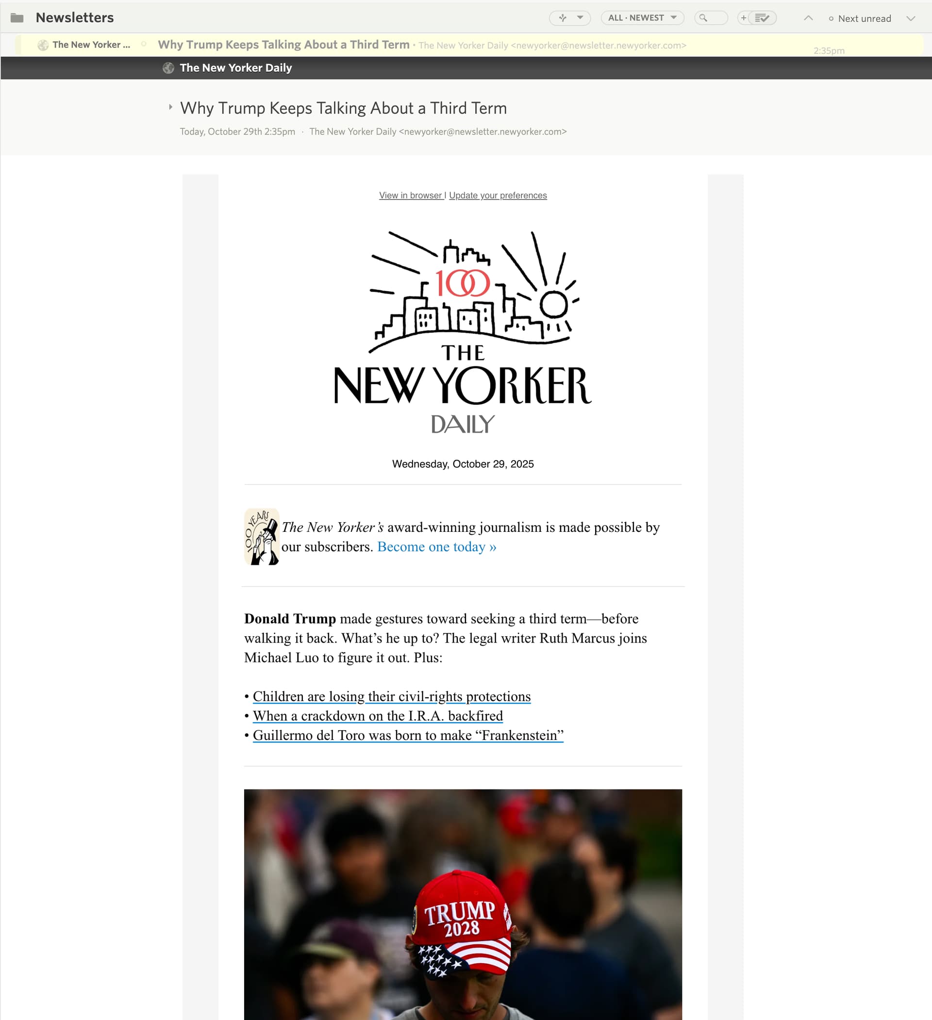

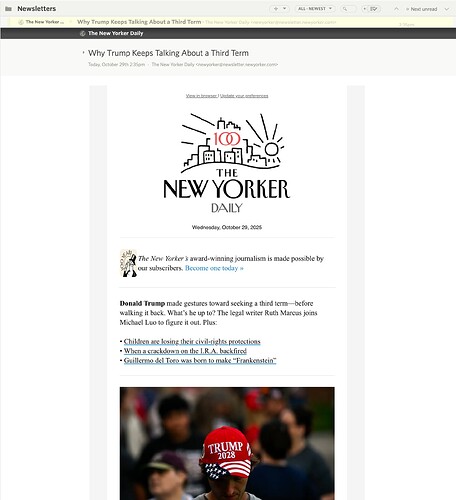

Found a smoking gun and deployed a fix. Looks like we were inadvertently scrubbing html5 tags that we shouldn’t have been. Future New Yorker emails should now come with content. I haven’t verified it yet myself, so I’ll be watching, but you should expect them to now work.
There we go, can confirm it now works.
