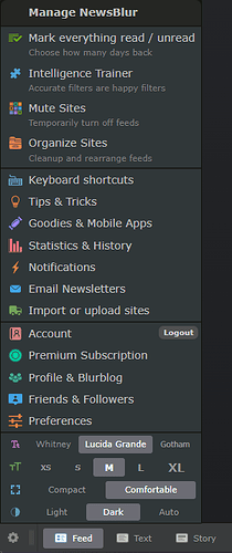

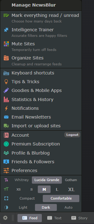

If click on the cog that brings up the main menu, There is an option called email newsletters. When you click on it. It will display a forwarding address that you can use. Should be (your address here) @newsletters.newsblur.com
