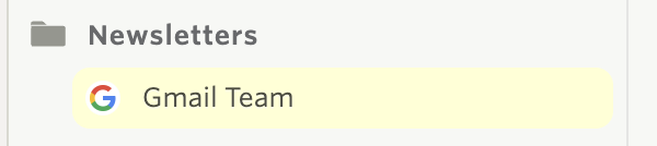

I’m trying to set up auto-forwarding in gmail for email newsletters but the verification email is not appearing in NewsBlur. A Newsletter folder is being created with a Gmail Team site (see attached), but the feed is empty even after refreshing for ~1 hour.

Confirming the email is the same one from the Manage > Email Newsletters location. I deleted the Gmail Team site and had Google resend the verification email. The Gmail Team Site appeared again in NewsBlur but remains empty.

That’s curious, you have a Gmail verification “feed” but it has no stories.
Yea… any advice on how I can see that email? Given the creation of the Gmail team feed it means something has to be happening, right?
I suspect there was a bug on the NewsBlur side that was stripping the email and failing. I believe it’s a missing body, but…
And I found the bug and fixed it four days ago but forgot to post on here. Try now!
