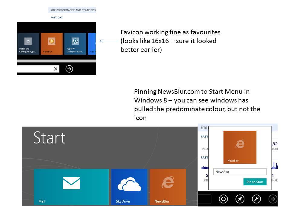

Hi
Unfortunately still no Joy - I think my 64x64 bit may be wrong, I’ll guess the MSDN post would work tho.
I actually think the favicon looks worse quality now than 2 hours ago - kind of looks like it’s only working at 16x16.

Hi Samuel
Still no joy at the moment,
only things I can see different so far from the MS are:
*you have a leading “/” in this line of code in front of the media part and the MS example doesn’t ()
*the MS guide says the PNG should be 144x144 - the one your pointing at looks to be 128x128
*I wonder if you do the “msapplication-TileImage” if you have to also do “msapplication-TileColor” (which I assume would be orange of sort shade

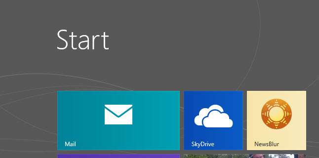

Hi Samuel
Screenshot attached - it works great.
I’ve now pinned NewsBlur to my Win8 Start Menu and it looks like a full piece of software.
Thanks for looking at this - really appreciate your time on it.
