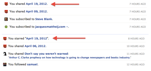

As I said item X was shown as shared in the dashboard. Its button should have changed to “Shared” but it didn’t. When I clicked on share, it appeared again on my dashboard as shared.
You can see it in my dashboard. You shared April 19, 2012. appears twice. Although in my blurblog it appears only once.April 19, 2012 is the item X in the above.
