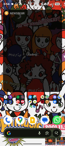

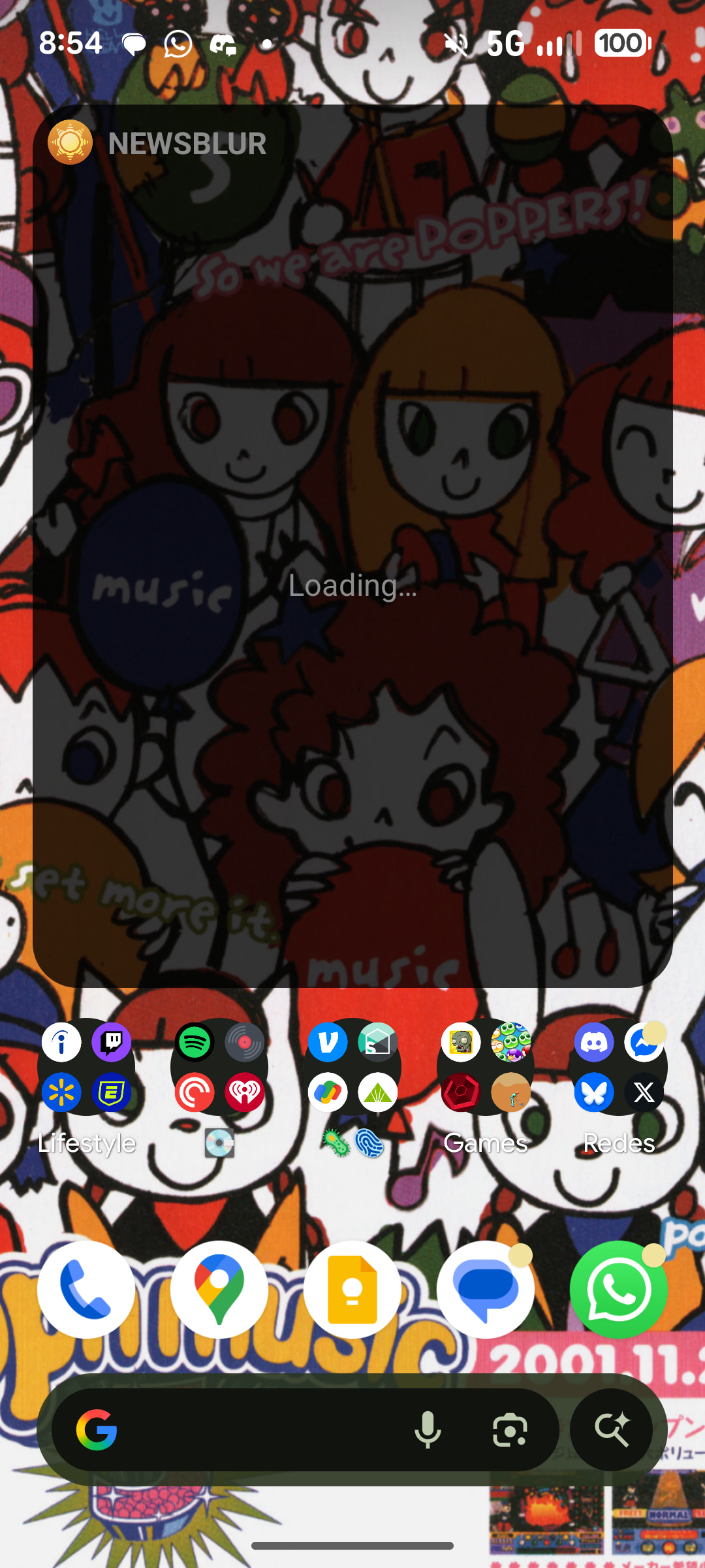

I love the android widget and it’s the main way I interface with Newsblur but have been running into an issue where the widget will hang on the loading screen. I know its not an issue with the app because when I open it, my feeds will be there, working just fine.
Anyone else running into this problem?
For context - this is android 16 running on a google pixel 6a
Any ideas @andrei?
@gaucheGoose Does it recover by itself or does it stay stuck loading?
If it doesn’t load, sometimes if I open up the proper app the stories then show up in the widget when I go back to my home screen.
