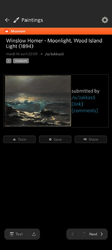

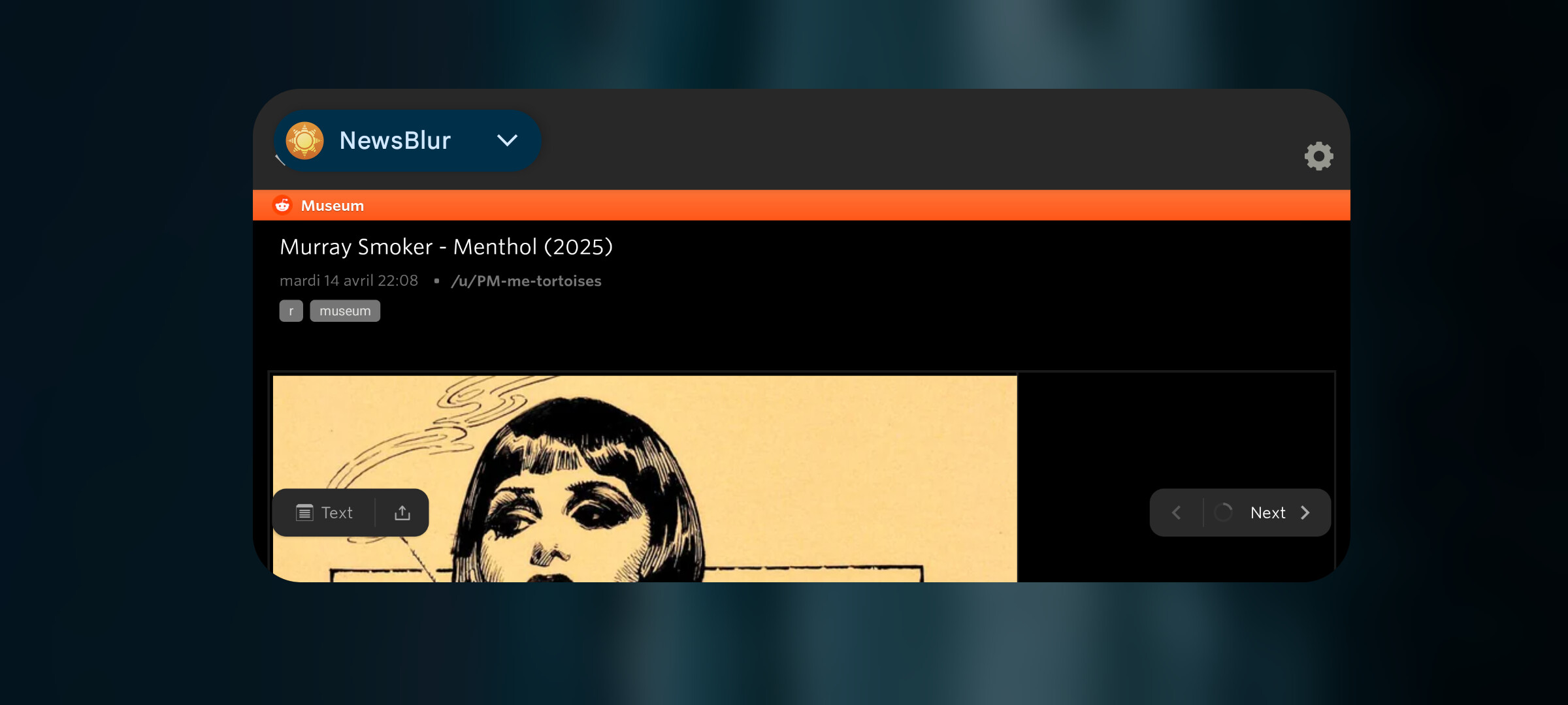

Hi
There’s a bug with the android app, turning the phone mark the story as read and goes to the next one.
When on a story:
Then while turning the phone it goes to the next one:

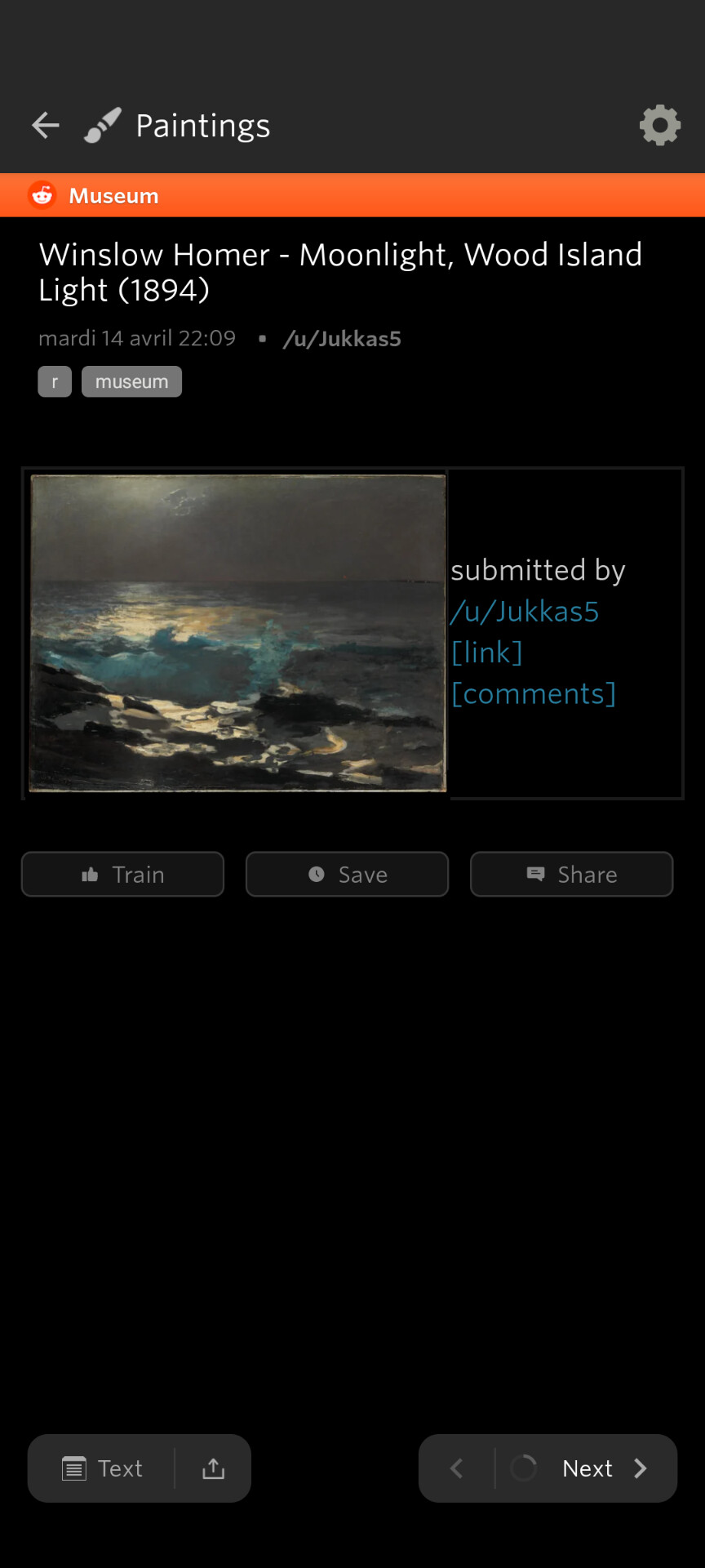

Hi
When on a story:

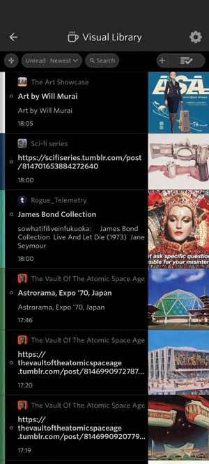

still happening with 14.3.2: i just triggered it from the all stories list.
