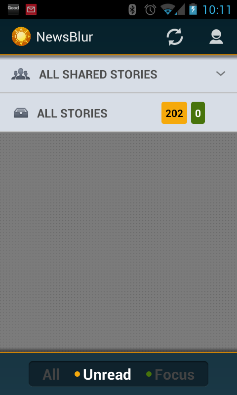

An image demonstrating the incorrect unread count (Notice there are no unread stories under an of my folders).
Oh, it’s on the Android app. Yeah, that thing is a piece of work. My recommendation is to switch to Blar if the official app is giving you guff. I have plans to overhaul it.

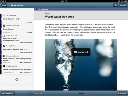

It is happening in the IOS App to. Want a screenshot of the IOS app doing it?
For what it is worth it does not happen on the site only in the native apps.
The iOS app is the same as the web. There should be no differences between the two, since they hit the same API endpoints. Make sure to pull to refresh on the iOS app.
Screenshots of the impossible :slight_smile:
IOS
Web
I’m feeling dense. What’s the problem? They look synchronized.
990 Unread stories in IOS
6 Unread Stories on Web
Sometimes if I get the web to 0 when I reload on IOS or Android I can actually see the “Phantom” stories. Then I can mark them as read.
