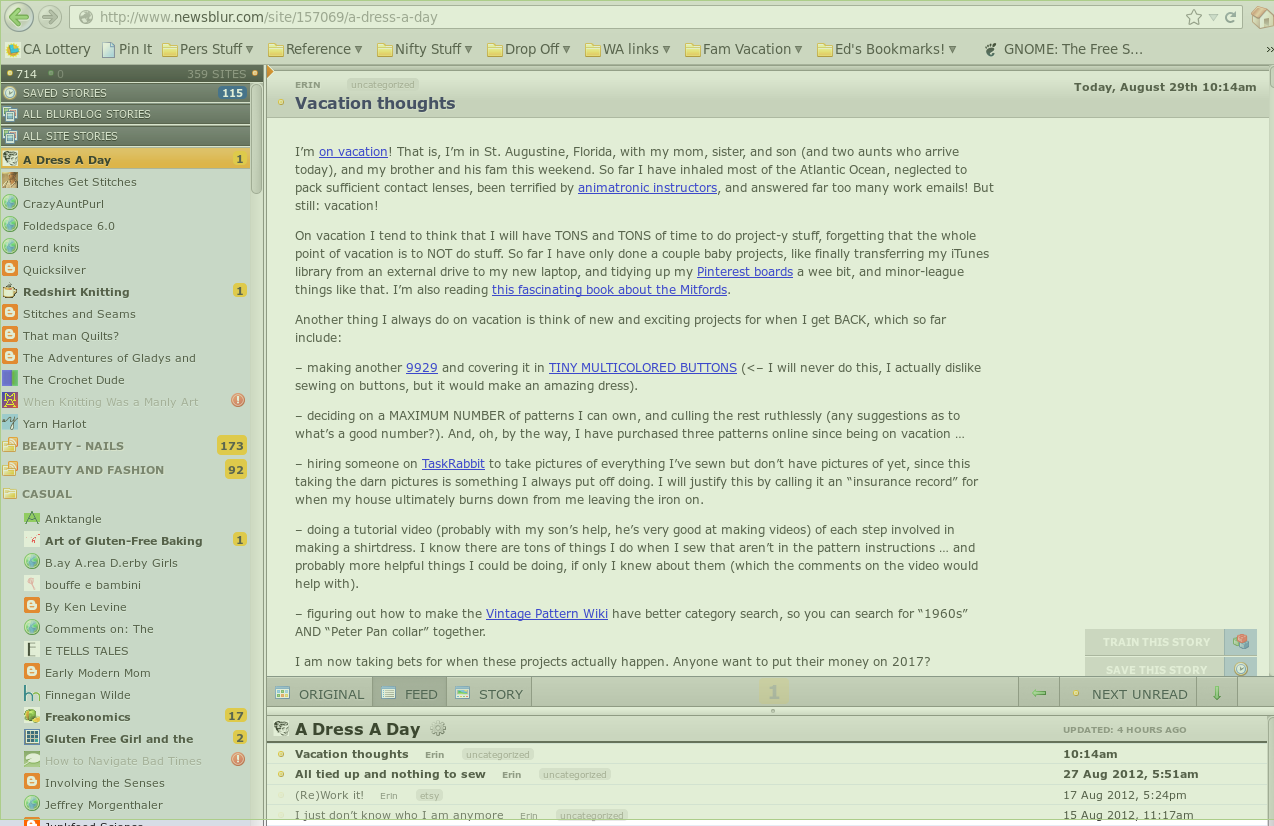

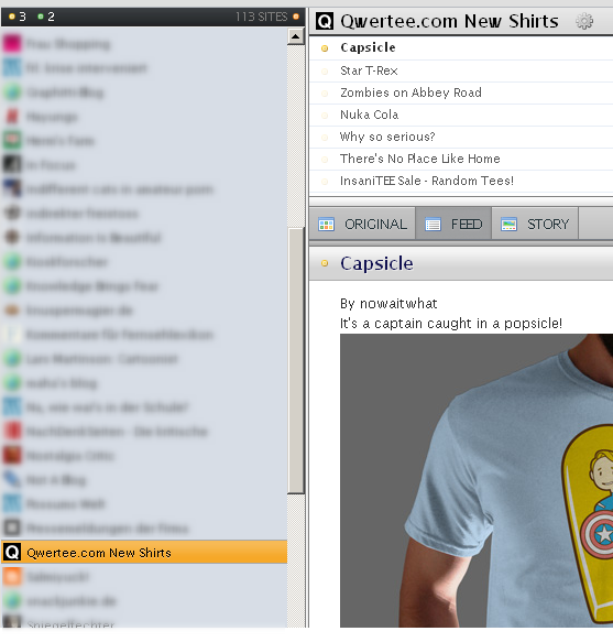

I thought I’d put up a screen print of the problem, in case that would be helpful. The part that isn’t clear to me is how there could be a 36 + hour slave lag, but it’s entirely possible (likely, even) that I just don’t understand the process well enough. Thanks for continuing to work on this issue!
(Sorry for the green overcast on that image - I have no idea why it’s there. My actual screen does not have that, of course.)

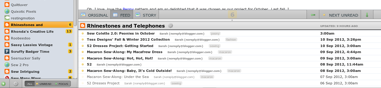

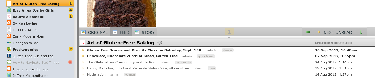

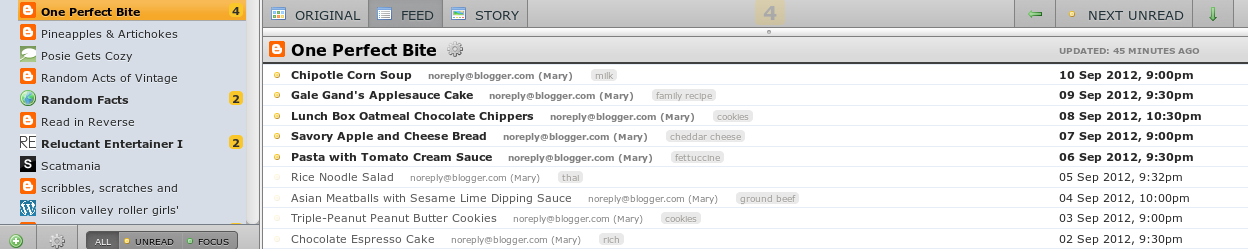

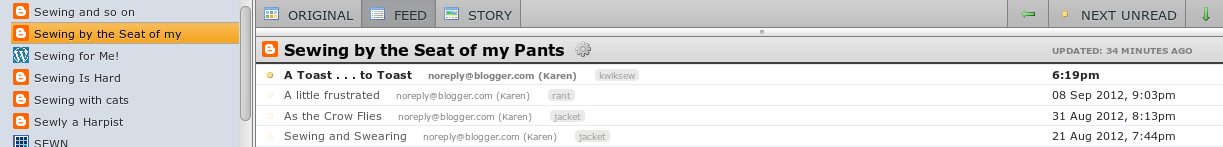

Nope - just web (Firefox 15) on one desktop linux box. I’m pasting in a few screen shots of the problem - taken a minute or two ago, just to be sure I’ve explained myself re: what’s actually happening. In these examples, the count is non-zero and also incorrect, but this happens with equal frequency when the count in the sidebar is 0 and the story pane shows 1.

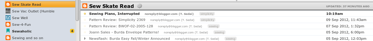

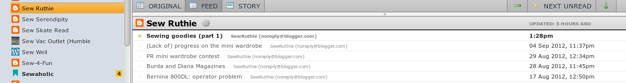

Here are three more examples where the count is 0 in the sidebar and correctly 1 in the story list (also from just now - 11:42pm Sept 11). I guess I’m hoping that you may see something that I’ve failed to notice or convey.
