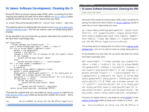

I read programming blogs which frequently show code snippets inside
 tags, where linebreaks and spacing should be preserved (and they were in that g----e product). Unfortunately, in newsblur the code is all run together, making the code snippets unreadable in "feed" and "text" views. Here is an example (with reader on the left and newsblur on the right):
 [![](https://d37wxxhohlp07s.cloudfront.net/s3_images/874172/reader-newsblur-compared_inline.png?1363695435)](https://d37wxxhohlp07s.cloudfront.net/s3_images/874172/reader-newsblur-compared.png?1363695435)
 This misbehavior is seemingly identical on www and dev.

I found that by installing stylish and applying the following site style, my experience in newsblur is improved:
@-moz-document domain("dev.newsblur.com") {
pre { white-space: pre-wrap !important }
} ``` other browsers besides firefox may have their own ways to override site styles.

The problem appears to have been fixed by the following commit in git: https://github.com/samuelclay/NewsBlu…
thanks wombleton, whoever you are. (though I may keep my white-space: pre-wrap hack as it improves pre blocks with very long lines)
Yup, I merged the pull request. Glad it worked!
